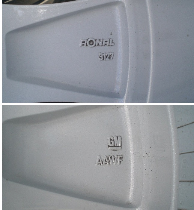

Material mojich orig alu je AlSi9. Mimochodom su Germany.

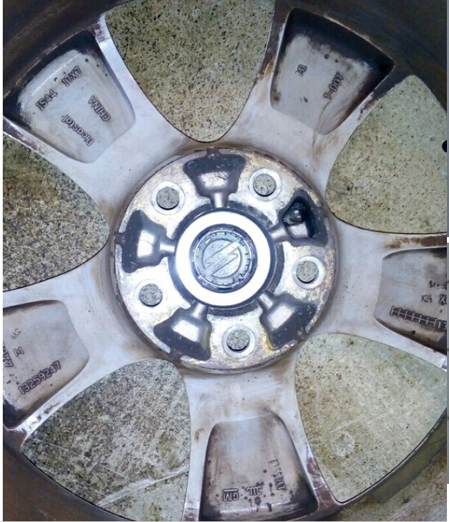

Niektoru GM su cinske - Dicastal China - vyzera taka kvalitnejsia cina:
Ronal Germany:
Citic Dicastal achieved yearly-best-supplier award from GM
[2011-04-20]
http://www.dicastal.com/en/index_mnewlook_t12_i16.html
